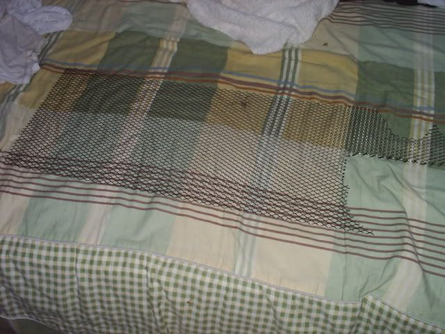

Suggestion: put a black steel mesh under/ in front of the intercooler, to avoid too much stones from whacking it and install a flat fan pulling air over the core...this would perfect in traffic/ standing still as the intercooler gets cooler and you have additional air circulating around that hot wankie(connect it with a switch, then you have one more thing to play with :biggrin: :biggrin:)......

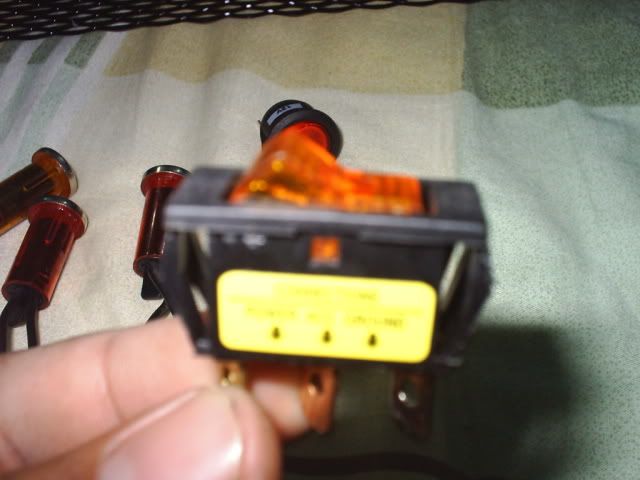

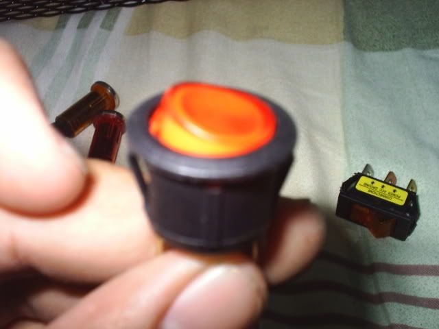

kid you rock man , you read my mind , mesh is already marked to be cut , also black in color :evil: , now the fan i already have a 16 in fan for the rad , but i think i have a couple of 12 in fans laying around i think i can make somethin out of them , switches are already in my toolbox

MO POWER with the mesh
switches

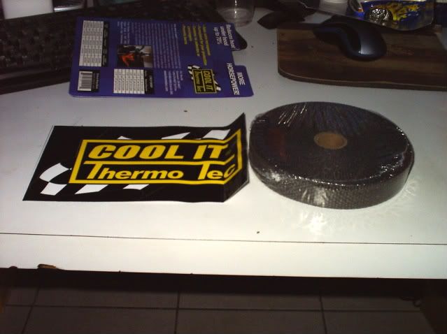

2. install the heat wrap on the DP .
anymore places i can check for boost leaks ? any one ? thank you
pix, of the the heat wrap , thanks again to 2Bar ( everyparts)

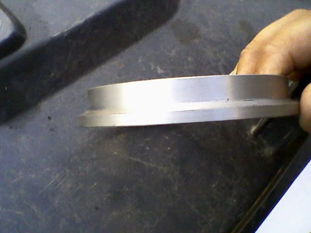

well long story short ,
a new v-band Flange had to be made since the turbo has a 3.90 O/D on the flange and 3.25 I/D .
so off to Trimon welding shop and they made one for me . lets say i was amazed :cool:
now the flange is being installed at the muffler shop , and a new o2 bong will be welded for the wide band since the narrowband is already in place
no pix yet .. :blah:

pix of the flange made by Trimon welding shop , :cool:
