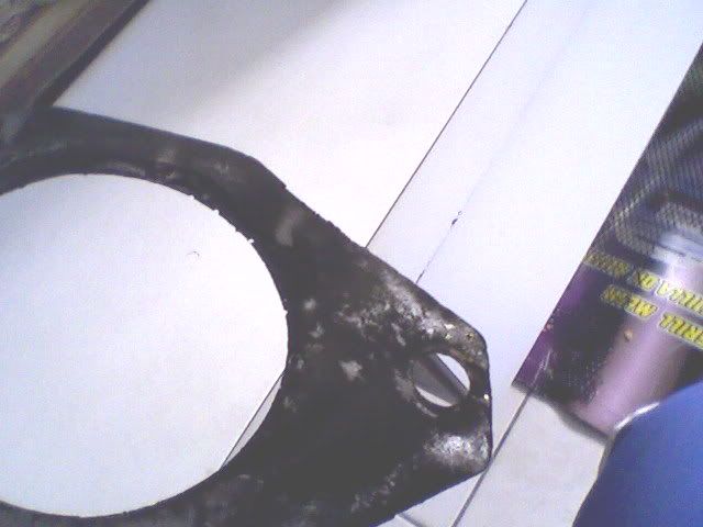

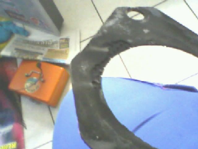

well found the biggest problem to the boost loss , Broken Manifold gasket,
thats why the car is still boosting but little , only 3psi ,
and 1 more vacuum line under the mani fold that blew off
pix of the carnage , lol

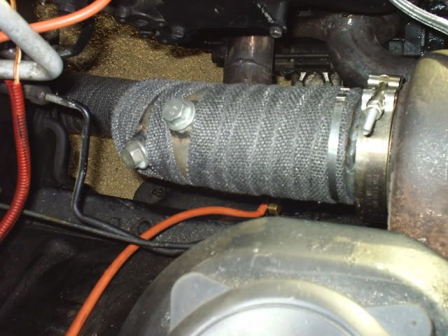

things that where done today
1.Heatwrapping the downpipe
2. close the last vacuum nipple that was open
3. double check hoses and clamps
Results of the heat wrapping
Before
AIR temp 52C
Coolant temp 95C
After
AIR temp 44
Coolant temp 77C
All Results where at IDLE for 20 mins dataloging last 2 mins
differiencia notabel.
Anto esey ta djis riba e DP.
Ainda falta 1 roll mas pa e Turbo manifold , anto e insulation pa e hot side.
Pic of the Downpipe wrapped.
E la keda hopi bon lora...

update on the heat wrapping final results
car runs cool, plus in cabin temps na e passenger a baha por completo

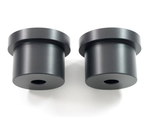

3.solid differential mounts ( wheel hop hater )
pix of these items
1.
2.
3.
