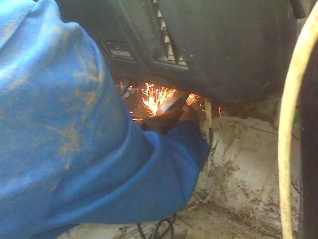

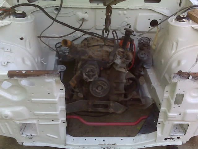

engine fitting has begun
1st victim : the Transmission tunnel
2nd victim : the 3K engine mounts
PIX
Trans tunnel being Cut

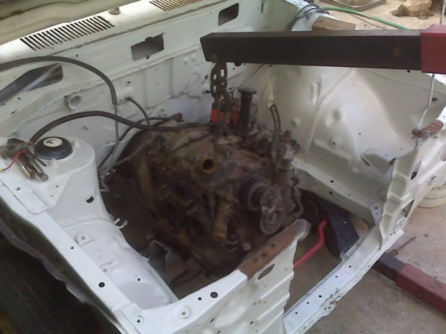

engine being fitted ( is not the final engine position yet)
what is left to do is cut the crossmember
and box it in so that the oilpan doesn't hit it
PIX

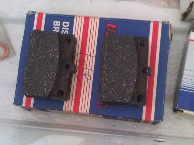

little update
small batch of parts has just arrived today ,
parts list
1. new Master cylinder
2. caliper repair kit
3. New metallic brake pads
4. 2X New brake rotors
if the car doesn't brake now it never will !

Brake Pads

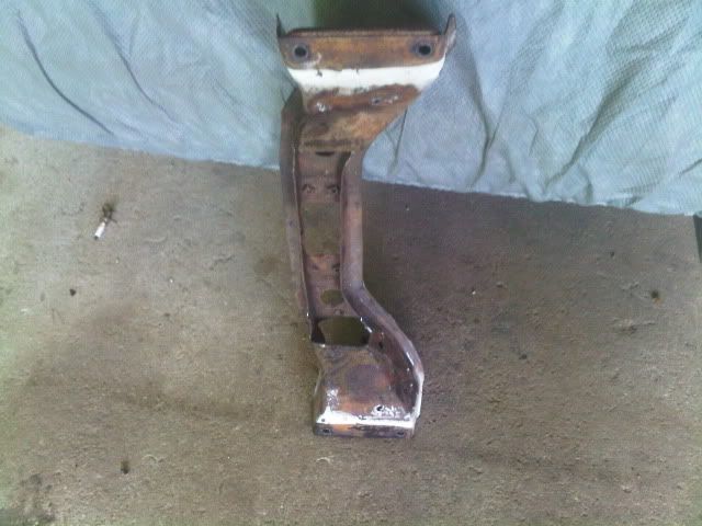

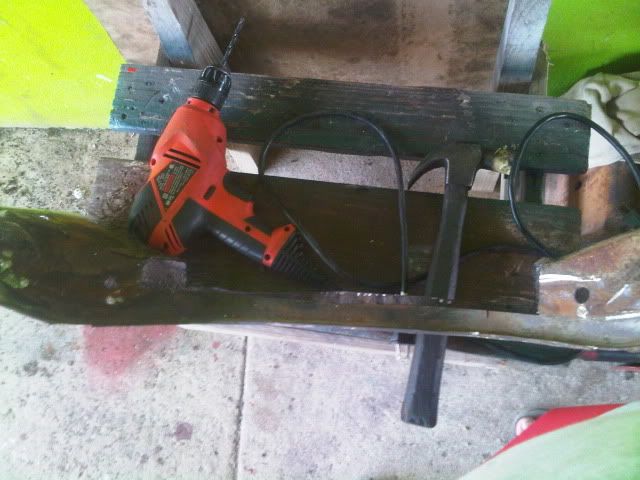

Project updates :
well great progress on the engine fitting
things that have been done are the following
1. New Transmission support made for the 13b transmission
2.OEM Toyota engine cross-member notch and weld (also removing the old 3KC engine mounts completely to make the engine bay clean )
3.Totally New custom Engine cross-member to support the new 13b power-plant (all done in house )
4.alloy solid motor supports ( oem Mazda rubber engine supports will be placed later for less vibration and streetabilty )

OEM toyota cross member under the knife
Stripped and ready for welding
welded and ready for prep and paint
13b engine cross-member welded and ready to be mounted for testing
13b mock-up with the custom cross-member ( hence the bare metal rusting )

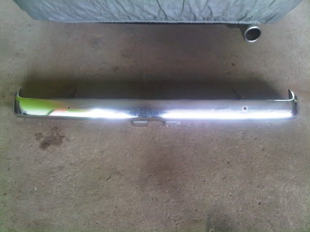

new to me rear bumper (bit dirty tho )
comparison of the new and old bumper
