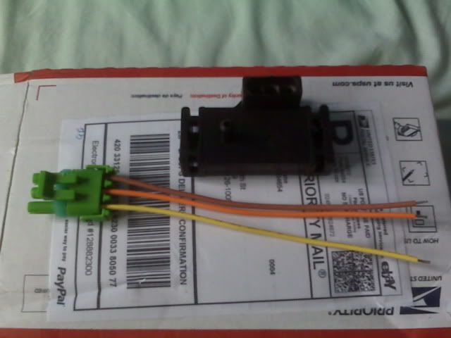

ma tuma e chens pa buska un external map sensor pa mi por hanja mi aux input back pa mi por husa e otro features di e Standalone P/E antilag/2step

1. GM 3 bar MAP sensor

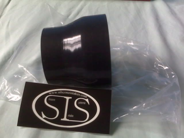

2. 3.25 to 2.5 IN reducer 4PLY (black not available in aruba)

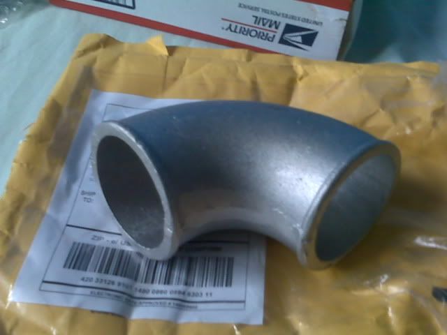

3. cast 90 degree bend 2.5IN (pa mi por hibe car pa nan install le intercooler )

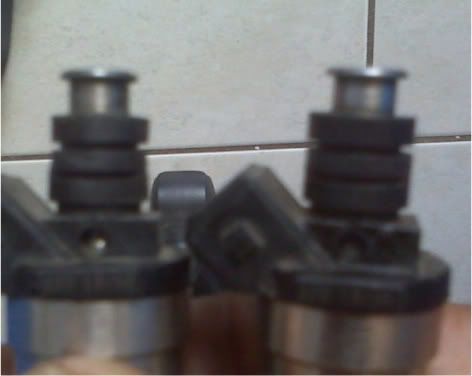

despues di basta tempo cu injection problems.
ma dicidi di hiba tur mi injectors pa flow test and cleaning.
A bin resulta cu 1 di mi secondary injectors no tabata traha mes (fabriek fout )
i e otro a cuminsa basha gasoline foi e sides nan i for di e plug (ULTRA DANGEROUS ) :thumbsdn:
ma purba saka pix pa boso wak e blown cap na e side dje injector (right one)
and to make it worse ... im out of warranty ...
so next step ,ta pa cumpra 2 nobo i start all over again

ki brand di injector nan ta?
uhm e brand ta Trickflow nan ta 120lb/hr ni 10 luna bieuw ohm
